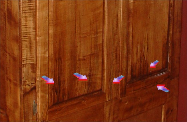

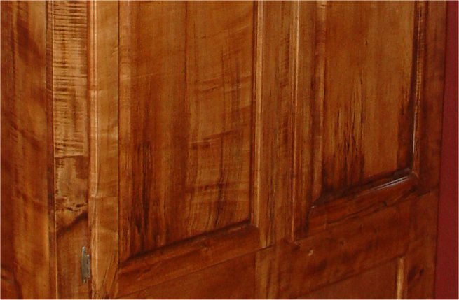

PostPosted: Mon Jun 25, 2007 2:28 pm
Posts: 567
Here is a shot of some doors. You can see the spalting streaking up from the bottoms. All of the photos I have found so far have just the stained spalting. I'll try to find some before and afters of other spalted moldings and post them.
chris
Chris Oliver
Infinity Luthiers
...in the shop.
live every minute...
PostPosted: Tue Jun 26, 2007 12:27 am
[QUOTE=Chris Oliver] Here is a shot of some doors. You can see the spalting streaking up from the bottoms. All of the photos I have found so far have just the stained spalting. I'll try to find some before and afters of other spalted moldings and post them.chris
I see lots of curl and crotch in this photo. I must be missing it but I do not see spalt.
PostPosted: Tue Jun 26, 2007 12:52 am
Posts: 567
There is a bunch. The stain really hides the gray and black. That is why I wish I had a before stain photo of these doors.

PostPosted: Tue Jun 26, 2007 12:57 am
got ya!
